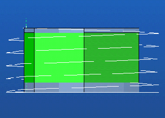

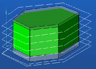

Share Email Facebook Twitter LinkedIn Helical side finish examples This option enables a small depth of cut and a continuous toolpath. It also avoids marks on the feature, which stepping down in Z depths may cause. Note: You must deselect the NT toolpaths option to access this option. Parent topic: Strategy tab (Milling)
