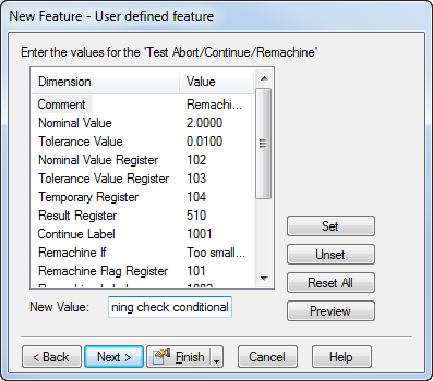

Test/Abort/Continue/Remachine
Comment — The comment is output in the NC code at the start of the test feature.
Nominal Value — Enter the measurement that you are testing, for example the diameter of a Bore feature.
Nominal Value Register — This is the register that the machine uses to store the Nominal Value
Remachine Flag Register — This is the register where the machine stores the count for the number of times the feature is remachined.
Result Register — This is the register where the machine stores the result of the probing measurement.
Continue Label — This is the label to jump to, to continue machining.
Remachine Label — This is the label to jump to, to remachine the feature.
Temporary Register — This is used to store any temporary logic needed to process the decision-making feature.
