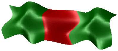

Two-surface blends
This figure shows a two-surface blend example. For this blend you must supply the curve on each surface to create this surface.

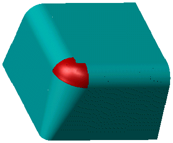

Three-surface blends
This figure shows a three-surface blend example. This blend is used to create what is known as a 'suitcase fillet'. This means that you want to create the intersection of three fillets like the corner of a suitcase. If you create the fillets with 3D modelling, the curves can usually be automatically detected.
