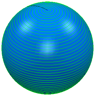

The example below shows you how to transpose the angular limits on the machine tool to the Azimuth and Elevation limits. These examples all use a sphere with an Isoline or Flowline Projection toolpath. If no tool axis limits are imposed, you will see the following toolpath:
