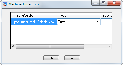

Machine Turret Info dialog
Use the Machine Turret Info dialog to specify the turret options. This dialog is only available for multi-turret parts.
To specify the turret options:
  1. For each item in the Turret/Spindle list:
    1. In the Type list, select the turret type.
    2. In the Subsystem list, select the machine subsystem ID defined in the VERICUT machine file.
  2. Click OK to close the dialog and save your changes.
