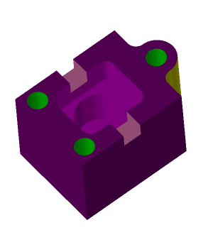

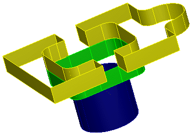

This example shows the milling features that are extracted using AFR and IFR method.
The image below shows the three side features created by the Automatic Feature Recognition wizard. The model has the advantage that the two slots are cut by the top feature. It has the disadvantage that top pocket is not represented by a single pocket.

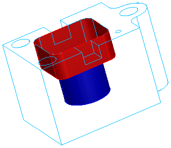

The image below shows the same example after using IFR. Each pocket is represented by a separate pocket, but the two slots are ignored.

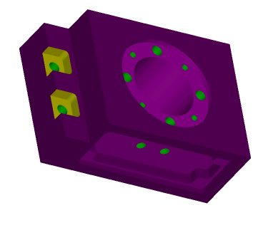

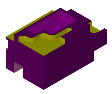

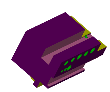

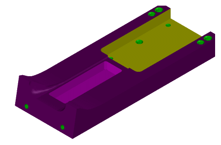

The following examples show features that have been recognized using feature recognition.
Pockets
Holes
Sides
Slots
