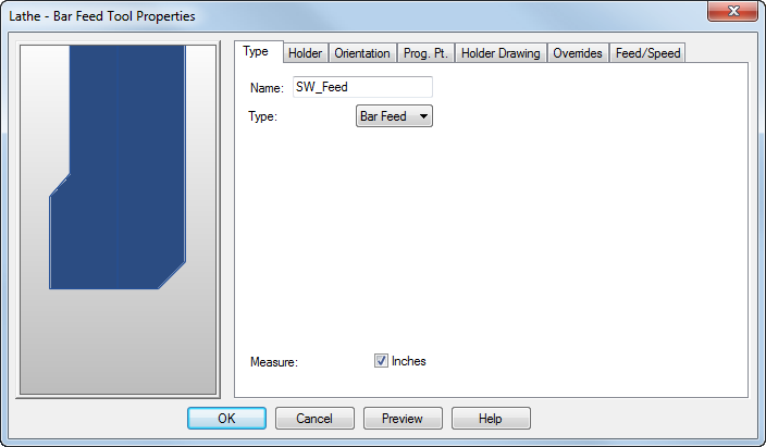

The Bar Feed tool group represents both bar feeders and bar pullers. This tool group has a Type tab instead of an Insert tab.
Click the tool preview image to pan and zoom it. The orientation of the preview is determined by the settings on the Options > View > Machine page. Right-click the image to access a context menu.
Name — Enter a name that identifies the tool. The name must be unique among all the tools in the crib.
Type — Select Bar Feed or Bar Pull.
Measure — This indicates the units that are used for reporting the tool’s dimensions. Select Inches for inch units or deselect it for millimeters.
Bar Pull tools have additional options:
Depth is the depth of the puller
Max. Diameter is the maximum diameter of the puller
