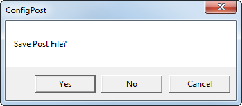

When you select File > New, ConfigPost prompts you to save the current Post file.

When you select Exit, you are prompted to save the Post Configuration file.
Click Yes to save the current Post file to the hard drive. If the name of the Post file was not defined, the Save As dialog is displayed, where you can specify the file name and the directory name for the Post file.
Click No to discard changes and close all windows.
Click Cancel to return to the current window.
