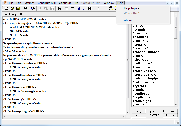

Use the options on the Help menu to access various sources of information about PartMaker.
Help Topics
Use this menu option to display the ConfigPost user guide PDF.
What's this?

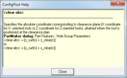

Use this menu option to display information about a valid reserved word in a separate ConfigPost Help window, for example:
You can access this window by using the:
  • Help > What's This? menu option.
  • Pop-up menu over the editor.
  • Pop-up menu over the list of reserved words.
Accessing What's this? command through the main menu Help > What's this?

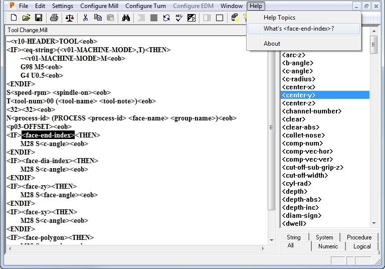

  • If the valid reserved word is highlighted in the editor, for example <face-end-index>, the menu changes to Help > What's <face-end-index>?

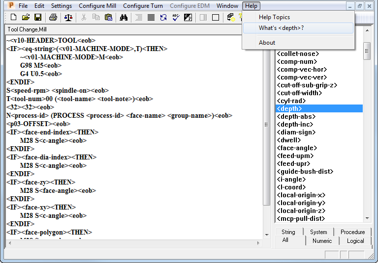

  • If no valid reserved word is selected in the editor, but reserved word, for example <depth>, is selected in the list of reserved words then menu changes to Help > What's <depth>?
  • If neither valid reserved word is selected in the editor, nor the reserved word is selected in the list of reserved words then the menu displays the generic name Help > What's this?
Accessing What's this? command through the context menu over the editor
When you right-click a valid reserved word, such as <face-end-index>, it is highlighted and the context menu changes to:
Accessing What's this? command through the context menu over the list of reserved words
When you right-click a valid reserved word in the list of reserved words, such as <depth>, it is highlighted and the context menu changes to:
