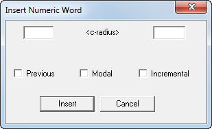

  1. If you select a numeric reserved word, the Insert Numeric Word dialog appears. You can insert the word as a modal or incremental word, or use the value of the previous reserved word.

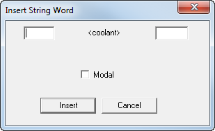

  3. If you select a string reserved word, the Insert String Word dialog appears. You can insert the word "as is" or as a modal word.
