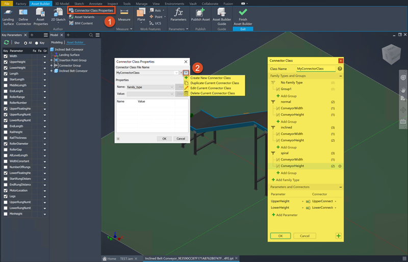

The Connector Class dialog is designed to streamline your workflow and make the creation of connector classes easier than ever before. With this new dialog, you can now create, edit, and manage properties directly through a user-friendly interface. This eliminates the need to manually handle XML files.
You can access it from the Connector Class Properties dialog:
On the Asset Builder tab, in the Author panel, click Connector Class Properties
.In the Connector Class Properties dialog, click Connector Class

You can now quickly and easily define key parameters such as family_type, connector_name, and value_source without the need to manually edit XML files.
