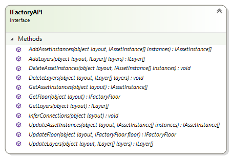

The API provides the following methods:

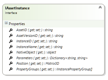

Four methods operate on asset instance objects:
To get the AssetID of an asset, refer to the Family ID in family.xml.
An asset instance supplies the following Factory Design data.
- Instance ID
- Parameter names
- Parameter values (value returns and updates in centimeters)
- ID of the asset used to construct the instances
- Name of the layer the asset instance resides on
- Access to the native CAD object that represents the asset instance in the document: ComponentOccurence in Inventor, and BlockReference in AutoCAD
AddAssetInstances
Use this API to add new asset instances to a layout. Each instance must specify the position where the instance will be placed, and the library asset that will be used to construct the instance. Optionally, the caller can specify parameter values to be used to construct the instance. If parameters are not specified, default values from the library are used.
using APIv2 = Autodesk.Factory.PublicAPI.Objects.v2;
var api = Autodesk.Factory.PublicAPI.API.Instance;
APIv2.AssetInstance newInst1 = new APIv2.AssetInstance()
AssetID = "41c84844-7b28-4903-bebd-365ca3a6a53c", //Straight Belt Conveyor
Position = new System.Windows.Media.Media3D.Matrix3D() { OffsetX = 0, OffsetY = 0, OffsetZ = 0 },
var insts = api.AddAssetInstances(layout, new PublicAPI.Currency.v2.IAssetInstance[] { newInst1 });
System.Windows.MessageBox.Show(insts.Length.ToString(), "Added instances");GetAssetInstances
var insts = api.GetAssetInstances(layout);
System.Windows.MessageBox.Show(insts.Length.ToString(), "Get - COUNT");UpdateAssetInstances
This API is used to change the instance position, parameters, and properties.
foreach (var item in insts)
var position = item.Position;
position.OffsetX += 200;
item.Position = position;
item.Parameters["Length"] = "400";
insts = api.UpdateAssetInstances(layout, insts);
System.Windows.MessageBox.Show("update position done");DeleteAssetInstances
api.DeleteAssetInstances(layout, new PublicAPI.Currency.v2.IAssetInstance[] { instToDelete });Two methods operate on the Factory floor object:
The floor object supplies the following Factory Design data.
- The center position of the floor
- The maximum X dimension (centimeters)
- The minimum X dimension (centimeters)
- The maximum Y dimension (centimeters)
- The minimum Y dimension (centimeters)
GetFloor
var floor = api.GetFloor(layout);
System.Windows.MessageBox.Show(floor.XPlus.ToString(), “+X Dimension”);UpdateFloor
floor.XPlus = 1000;
floor.XMins = -1000;
api.UpdateFloor(layout, floor);
System.Windows.MessageBox.Show(“Updated floor X dimensions”);Four methods operate on layer objects:
A layer supplies the following Factory Design data:
- The layer name
- The layer color
- A Boolean stating whether contents of the layer are visible or not
- Whether or not the color should be applied to 3D assets in Inventor
GetLayers
var layers = api.GetLayers(layout);
System.Windows.MessageBox.Show(layers.Length.ToString(), “Get – COUNT”);AddLayers
APIv2.Layer newLayer = new new APIv2.Layer()
Name = “Green Layer”,
Color = new APIv2.LayerColor(0, 255, 0),
LayerOn = true,
ApplyColorTo3FDAssets = true
var layers = api.AddLayers(layout, new PublicAPI.Currency.v2.ILayer[] { newLayer });
System.Windows.MessageBox.Show(layers.Length.ToString(), “Added layers”);
UpdateLayers
foreach (var layer in layers)
layer.Color = new APIv2.LayerColor(255, 255, 0);
layer.ApplyColorTo3DAssets = true;
api.UpdateLayers(layout, layers);
System.Windows.MessageBox.Show(“Updated all layers to yellow”);UpdateLayers
System.Windows.MessageBox.Show(“Updated all layers to yellow”);DeleteLayers
api.DeleteLayers(layout, new PublicAPI.Currency.v2.ILayer[] { layerToDelete });
