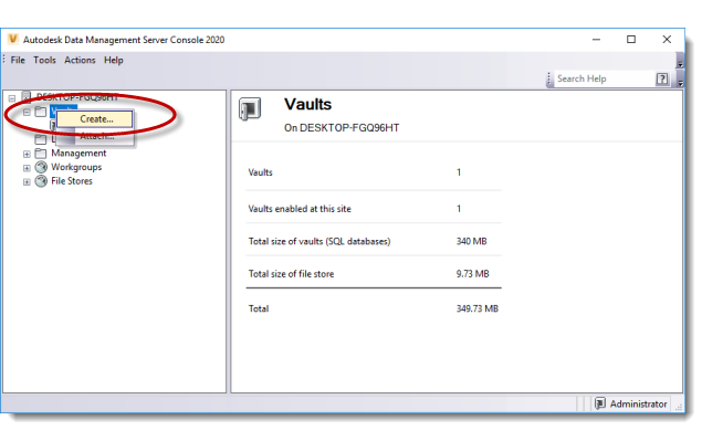

Create a Factory Vault

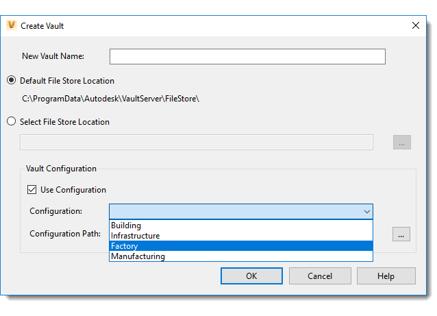

To create a vault for Factory Design content:
- From the Windows® Start menu, select All Programs > Autodesk > Autodesk Data Management > Autodesk Data Management Server Console.
- Log in to the ADMS Console.
- Right-click the Vault folder and select Create.
- Enter the name for the new vault.
- Select Use Configuration, and then select Factory from the Configuration drop-down list.
- Click OK.

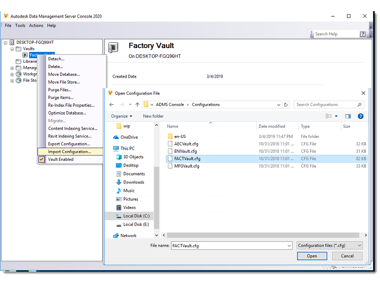

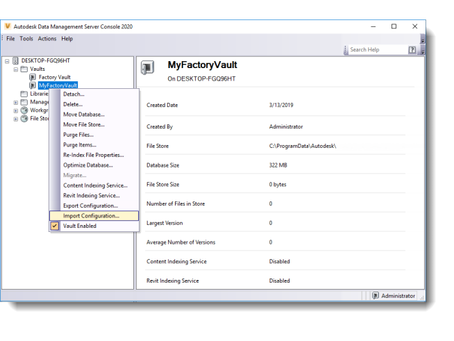

Import a Factory Vault Configuration into an Existing Vault
- Open the Vaults folder and locate the vault from which you want to import the configuration.
- Right-click on the vault and select Import Configuration.
- Go to the ADMS folder and select FACTVault.cfg.
- Click Open.

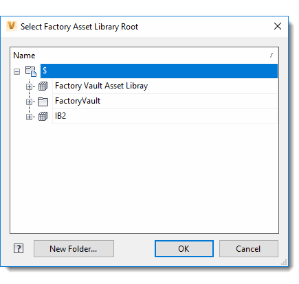

Step 2: Set Up Your Vault Asset Library
To set up a Vault folder as a Factory asset library:
- Open Autodesk Vault Professional.
- Log in to the Factory Vault server.

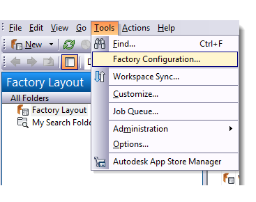

- Select Factory Configuration from the Tools drop-down menu.

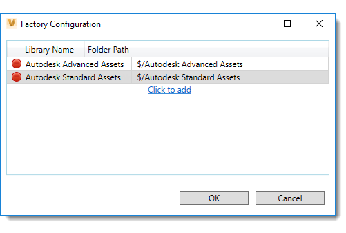

The libraries defined in this vault appear:
- Click Click to add to add a library.
- Select an existing folder or create a folder.
- Click OK.
The folder now appears in the Factory Configuration list.
Clicking
next to a library name removes the Factory Asset Library designation from the folder, but doesn't remove any folders or files from the vault.
