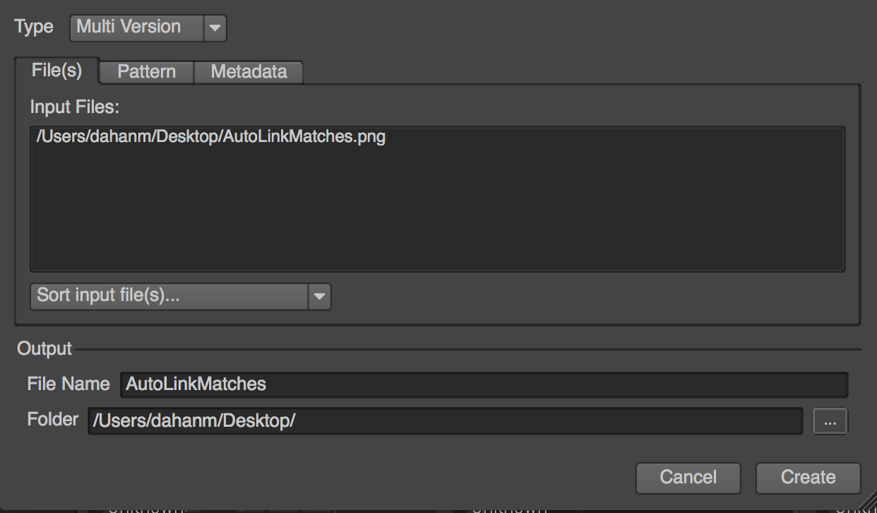

From the Flame MediaHub, a Create Open Clip option is available from the context menu when selecting one or more clips and selecting this option launches Open Clip Creator, as does launching the standalone application. The user interface is comprised of the following options:
Open Clip Type
- Type: Select the type of Open Clip(s) to create:
- Single-Version: Selected content creates single-version Open Clips. The name of the clip as seen in MediaHub is used to name the Open Clip files.
- Multi-Version: Selected content is consolidated in a multi-version Open Clip. The order of the selection defines the version order.
- Multi-Channel: Selected content is consolidated in a multi-channel Open Clip.
- Stereo 3D: Selected content is consolidated in a Stereo 3D Open clip. The order of the selection defines the polarity (Left/Right).
- Pattern: Select this option to create Open Clips based on tokens. See the Patterns section.
The Files Tab
File(s) tab: Displays the selected media files used to create the Open Clip(s).
Sort input files: Offers various sorting modes for the selected files:
- Sort by name: The list of files is sorted by name (default order is based on election order).
- Expand file sequence: Applies only to file sequences. Displays all the frames instead of the grouped sequences.
- Find file sequence: This mode groups files with the same base name into a continuous sequence, even if there are gaps in the sequence numbering. The resulting clips will display a checkerboard for frames with missing media.
- Find gap-defined file sequences: This mode groups files with the same base name into a continuous sequence. But where the Find file sequence mode ignores gaps, this mode uses these same gaps in numbering to define the start and end of clips.
