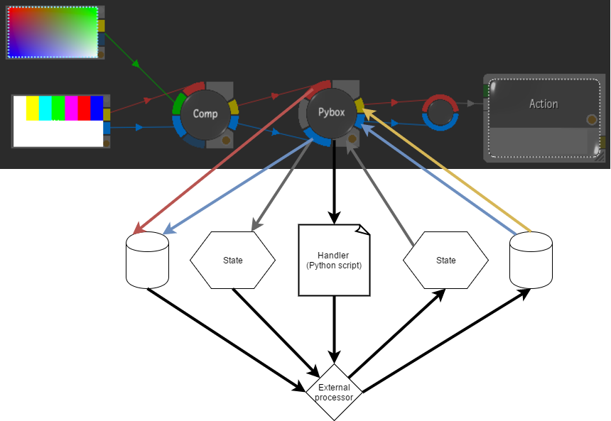

Interacting with Flame
There are three components used to interact with Flame: image file output from Flame, image file input from the external processor, and the JSON payload.
The Pybox is just a script that connects Flame to the external processor. But the script does not interact directly with Flame. Everything is passed through a temporary JSON file, which is itself completely stateless. And it is this JSON payload that is read by Flame.
JSON Payload File
The JSON file is what the handler and Flame use to communicate with each other. Flame is not aware of the external processor: only the handler is expected to interact with the processor.
