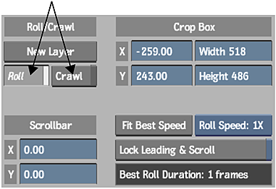

The Roll/Crawl controls are described as follows.

  4. Click Roll/Crawl to enter the Roll/Crawl menu.
  5. Go to the first frame of the clip, and enable Roll or Crawl.
  6. Click New Layer and add the text you want to use for the text roll or crawl.

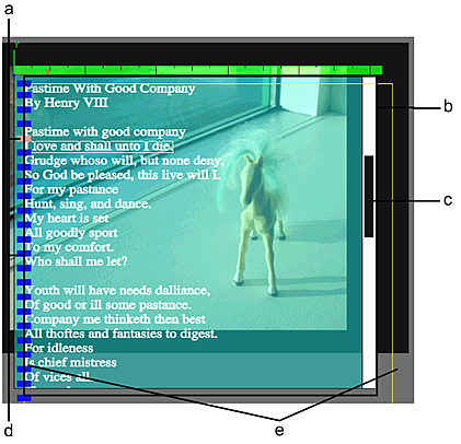

    A shaded layer appears in the image window with a vertical scrollbar for a roll or a horizontal scrollbar for a crawl. The shaded area represents the crop box area. The following is an example of a text roll.
    (a) Red indicates currently selected paragraph  (b) Crop box  (c) Scrollbar  (d) Blue indicates paragraphs in text roll layer  (e) Yellow border delimits text  

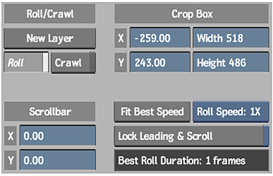

  7. To set the start position of where the text appears in the text roll or crawl, use the Scrollbar X and Y fields or drag the scrollbar up or down (roll), or left or right (crawl).
  8. Go to the frame where you want the text roll or crawl to finish and set the end position by dragging the scrollbar or using the Scrollbar X and Y fields.
  9. If you want to calculate the ideal number of frames for the text roll, choose a roll speed: 1X, 2X, 3X, or 4X.
    The suggested duration appears in the Best Roll Duration field. You can either change the number of frames in your clip to match the one in the Best Roll Duration field, or you can leave the clip as is.
  10. If the suggested duration is acceptable, enter it in the Duration field and then click Fit Best Speed.
    The roll is created and the Scrollbar position and Leading are changed (if required) and locked.
  11. If the suggested duration is not acceptable, click Fit Best Speed.
