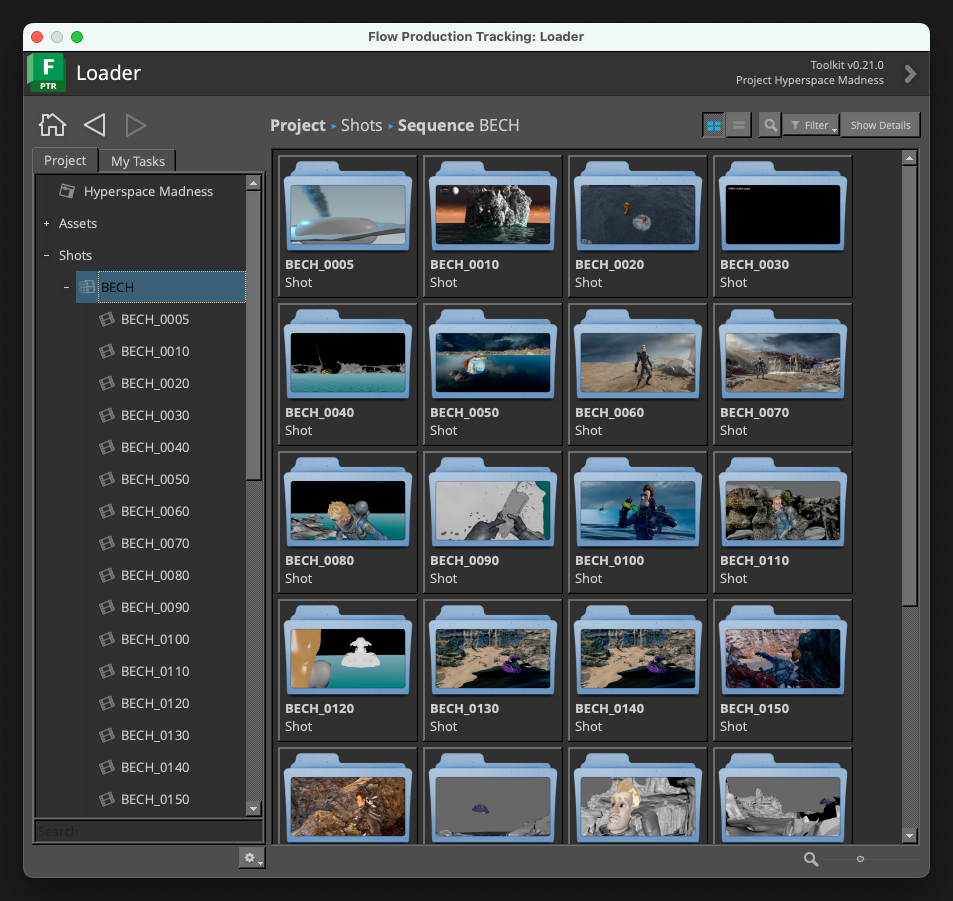

You can load assets from Flow Production Tracking into Flame using the Flow Production Tracking Loader.
The Flow Production Tracking Loader can be opened from the Flow Production Tracking submenu, inside the Flame menu. It is available for both the Plugin and Classic Flow Production Tracking implementation. It enables you to browse the different Sequences available in your Flow Production Tracking site and load the media inside Batch. The following options are available:
  • Import Clip: Import the selected clip in the current Batch Group.
  • Load a Batch Group: Append the Batch setup file from Flow Production Tracking to the current Batch Group.
  • Load as a Batch Group: Load a Batch Setup file from Flow Production Tracking to a new Batch Group.
  • Create Batch Group: Load the existing clips from a shot in Flow Production Tracking to a newly created Batch Group / Batch setup in Flame.
