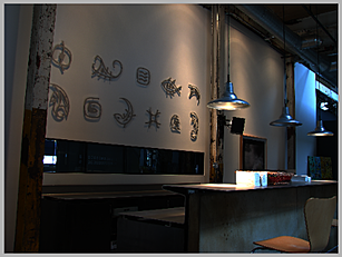

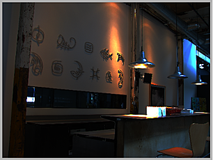

![]() Front view of a 16-bit floating point image | ![]() Result view of the image after the exposure and contrast have been modified |
