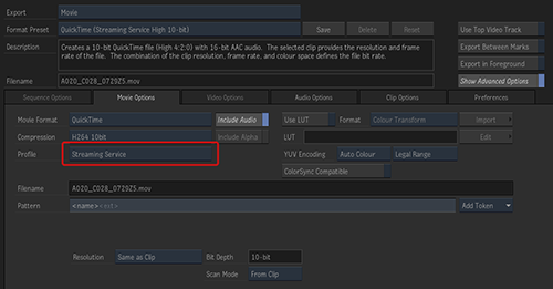

The new Streaming Service profile for H.264 files simplifies the export of deliverables of different ratio, resolution, and dynamic range.
The Streaming Service encoding profile, with Compression set to H264 10bit.
The Streaming Service profile exports H.264 QuickTime files at bit rate based on the resolution, ratio, and frame rate of the clip. The files are encoded using the 8-bit or 10-bit H.264 High profiles.

The following export presets are available in Format Preset Autodesk H.264 :
  • QuickTime (Streaming Service High 8-bit)
  • QuickTime (Streaming Service High 10-bit)

Using the Streaming Service profiles or presets also allows you to export a multiselection of content. The selected clips can all differ in resolution, frame rate, bit depth, and colour space: the Streaming Service profile will export each clip with its own bit rate. Only the bit depth applies to all.
To export multiple clips using the Streaming Service:
  1. Select the clips to deliver.
  2. Meta+E to open the Export menu.
  3. Set a destination folder.
  4. Set Format Preset Autodesk H.264 QuickTime (Streaming Service High).
  5. Export.
    Each clip is exported with a bit rate that matches its resolution, frame rate, and colour space.
