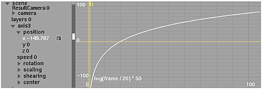

log
Returns the natural logarithm of a given number. The log function is the inverse of the exp function.
Syntax:log(Number)
Arguments:
  • Number is the positive number of which you want the natural logarithm.
Examples:
  • log(1) returns 0.
  • log(2) returns 0.6931.
  • log(exp(5)) returns 5.
  • log(256) / log(2) returns 8.
  • log(frame / 20) * 50 yields the following curve:

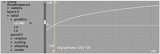

log1p
Returns the natural logarithm of 1 plus a given number. The log1p function is the inverse of the expm1 function.
Syntax:log1p(Number)
Arguments:
  • Number is the positive number less 1 of which you want the natural logarithm.
Examples:
  • log(0) returns 0.
  • log(1) returns 0.6931.
  • log1p(expm1(5)) returns 5.
  • log1p(frame) returns the equivalent of log(1+frame).
  • log1p(frame / 20) * 50 yields the following curve:

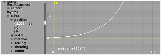

exp
Returns the constant e (the base of the natural logarithm) raised to the power of a given number. The exp function is the inverse of the log function.
Syntax:exp(Number)
Arguments:
  • Number is the exponent applied to the base e.
Examples:
  • exp(0) returns 1.
  • exp(1) returns 2.7182.
  • exp(2) returns 7.3890.
  • exp(log(5)) returns 5.
  • exp(frame / 20) * 5 yields the following curve:
