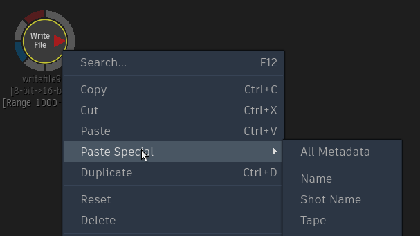

To paste metadata to a Batch node:
  1. Right-click a node or clip and select context menu Copy.
  2. Open the Batch Schematic.
  3. Right-click the target node and select context menu Paste Special All Metadata.
    Tip: Pasting with All Metadata is similar to the T+click shortcut.
Instead of pasting all available metadata, you can now paste only parts of it. In context menu Paste Special, you select the metadata to paste. Only the information relevant to the node are available. For example, you cannot paste a shot name on an GMask node, but you can paste it to a Render node.

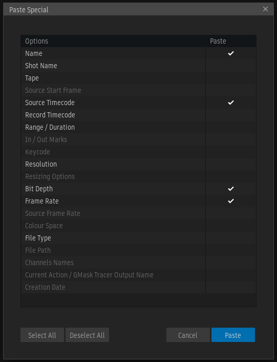

To paste only a subset of the metadata:
  1. Open the Batch Schematic.
  2. Right-click the target node and select context menu Paste Special Custom....
  3. In the Paste Special dialog box, click the Paste column to select the metadata to paste.
    Only the metadata relevant to the target node can be selected.
  4. Click Paste.
