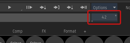

Batch Group Duration Automatically Set
Flame Learning Channel: Working Faster with Automatic Batch Durations
The Batch Group duration field is now automatically set to the duration of the first clip added to the schematic, instead of remaining at 100. The duration changes only you haven't already set it to a custom duration.
If you set the duration manually, an asterisk ( * ) now appears in the Batch Group duration field. This lets you know that the duration won't update automatically when you add a clip to the Batch Group.
Ctrl-click the Batch Group duration field to reset it to the duration of the first clip added to the Schematic.

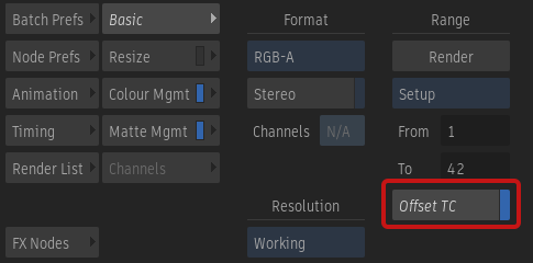

Offset TC in Exported Clips
The Range Offset button in the Render Node changes.
  • The Range Offset button is now named Offset TC (Offset Timecode) and moves to the Range section.
  • Offset TC is also available in the Write File node.
Note: Write File nodes present in setups from previous versions have this option enabled.

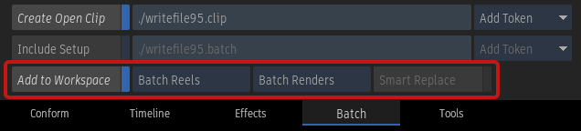

Add Exported Clips Back to the Workspace.
A clip exported using a Write File node can now be automatically added to the current workspace by selecting the Add to Workspace button.
Just like with a Render node, you select where the clip is added.
This option is not available when you export a clip using Burn or Background Reactor.

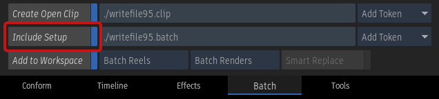

Bundling Render and Write File.
If you select the Include Setup in the Write File node, the created Batch Setup now includes every Render and Write File nodes from the Schematic.
The extra nodes are disabled by default when you create a new version by using the Open Clip's Create New Version option in the Timeline.

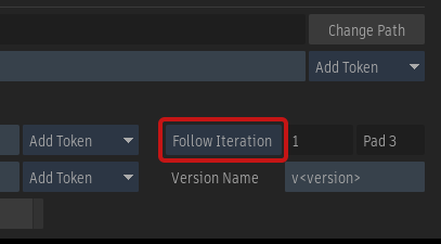

Open Clip Padding Follows Iteration padding.
In the Write File node, if you enable Follow Iteration, the Open Clip version now uses the same padding value as the Iteration of the Batch Setup.

Smart Replace relocation.
The Smart Replace button is now available in the Add to Workspace settings of the Write File node.

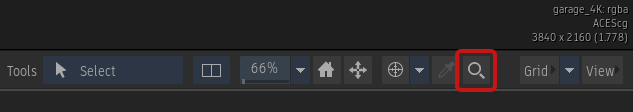

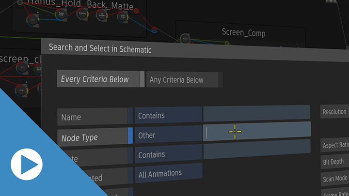

Search Nodes in the Schematic
Flame Learning Channel: Searching through Batch
You can now search for nodes in the schematic for Batch and the Modular Keyer.
In addition to being able to search by Node name and resolution, you can locate node in the Schematic based on:
  • Node type
  • Animation keyframes or expressions
  • Search notes
  • Errors present
You can also create Search presets for those often-used searches. These presets are accessible from the Search drop-down menu.

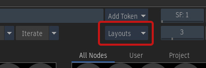

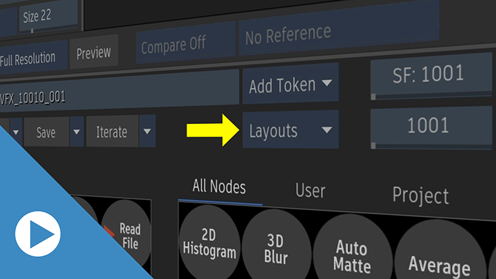

Layouts in Batch/BFX
Flame Learning Channel: Customising your UI with Batch Layouts
Layouts are now available in Batch and Batch FX.
The following elements of the Batch tab can be managed with a Layout:
  • Media Panel visibility
  • Explorer visibility
  • Viewport layout
  • Frames / Timecode display option
  • Duration / End Frame display option
  • Positioner state
  • Audio Waveforms state
  • Show Markers display option
  • Full Screen state
The Batch user interface changes somewhat to make room for the Layouts button:
  • The New Setup button moves above the Load Setup button. The Duplicate Batch and Clear Batch Setup options are now accessible from the Desktop (Duplicate Batch) and Batch Group (Clear Batch Setup) context menus in the Media Panel.
  • The Iterate button moves next to the Save button.
  • The Player button now appears in the Iterate old location.
  • The Layouts button now appears in the Player old location.
