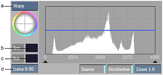

  1. Click Basics.
    The Basics menu appears.
    (a) Trackball option box  (b) Source Colour pot  (c) Destination Colour pot  (d) Luma field  
  2. Select Warp from the Trackball option box.

  4. Click the Src Colour pot to set the source colour.
    The Dst (destination) Colour pot is updated to match the source colour.

  6. To adjust the luminance of the destination colour, adjust the Luma field. When you adjust the luma of the destination colour, the entire luma content of the image is adjusted around the selection. The selected luma value changes the most.
    The Dst Colour pot dynamically updates to reflect your changes. When you release the mouse, the Src Colour pot is updated to match the destination colour. In the 2D luma histogram, the cyan bar moves to reflect the changes you are making to the luma content.
