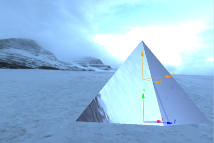

Image-based lighting (IBL) is the process of illuminating scenes and objects (real or synthetic) using images of light from the real world. This is in contrast to using only direct light sources such as point lights or spotlights, which are more localized. A typical use of IBL is taking high-dynamic photos of a chrome ball placed in the original environment of a live-action shoot, then using the photos as an IBL map to simulate the lighting conditions of the shoot. In Action, you can use the IBL node in Reflection mode or Ambient mode (which more closely simulates a global illumination effect).

  • You can use IBL maps to make surfaces perfectly reflective or perfectly diffuse. You can also make an IBL map act as a virtual spherical background plate.

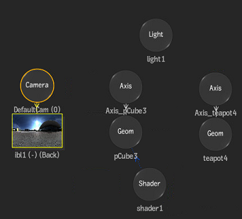

  • Action supports angular, cubic, and lat-long (cylindrical) IBL mapping types. You can use the Map Convert tool to convert images to one of these types.

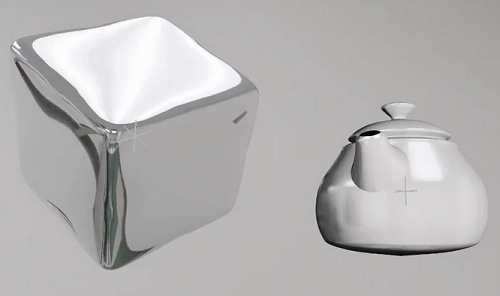

  • IBL maps work well with PBS shading in Action. One IBL map can be used for both PBS and standard shading in the same scene:
    The cube has a Physically Based Shader attached, so its settings override the IBL shading settings.
    The teapot uses the IBL menu's Standard Shading.
