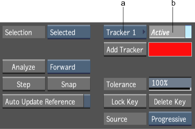

  2. If the tracker and reference boxes do not appear on the image, select the appropriate Tracker, from the Tracker box and enable Active.
    (a) Tracker box (b) Active button  
