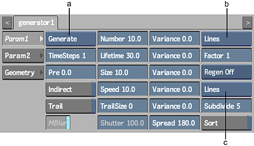

From the Particle Generator menu, select Explode from the Stream Type box.
(a) Stream Type box (b) Interactive Type box (c) Render Type box
From the Render Type box, select Polygon as the particle type.
To view the explosion as you make changes to your particle stream, change the Interactive Type box to Polygon as well. See Setting Particle Rendering Properties.

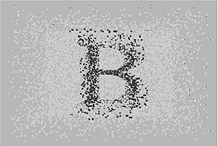

The following figure shows the schematic and the result of exploding a 3D object of an apple. The number of polygons is set to 200. The result shows frame 20.

The following figure shows the schematic and the result of exploding a surface with diffuse mapping set to Wrap.
