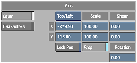

Modifying Layer and Character Properties
Use the Layer controls in the Axis menu to rotate, translate, scale, or shear a selected layer and to apply an effect uniformly to all characters.

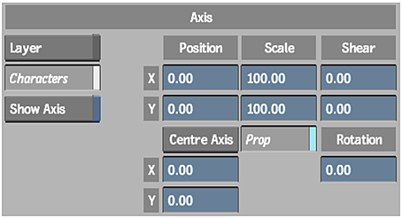

Use the Character controls in the Axis menu to view and position the axis of each character. You can use the position, rotation, scale, and shear settings for each character in a layer to create an effect of scrambled letters.
To edit text characters, you must be in Move or Edit mode and some text must be selected. The Layer and Character controls are described as follows.
