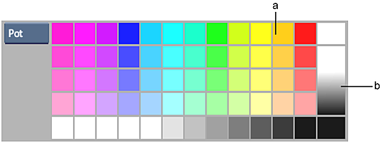

The Colour Palette
The colour palette appears in the Paint, Graphics, and CutOut menus. It contains the scratch pad and colour gradient. A series of colours are stored in the colour palette in colour pots. To select the current colour in the colour palette, click a colour pot. To set the current colour, press and hold a colour pot.
(a) Colour pot (b) Colour gradient bar
Build your own colour palette by storing the current colour in the colour pots. You can also save and load colour palettes.
To store a colour in the colour palette:
To display the colour palette, swipe the bar at the bottom of the screen.
The colour palette appears.
Tip: If you do not see the palette, click the Palette button. To hide it, swipe the bar a second time.Set the current colour.
Click a colour pot in the colour palette and hold the cursor down momentarily.
The colour is saved in the colour pots.

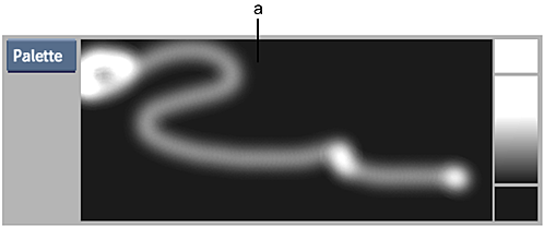

The Scratch Pad
Use the scratch pad to mix colours selected from the image or colour pots and to test the selected brush type. You can also paste cutouts into the scratch pad to use when mixing colours.
(a) Scratch pad
To mix colours on the scratch pad:
Click the Pot button.
The scratch pad appears.
Paint on the scratch pad.
Change the current colour and paint over the previous brush strokes.
The colours are mixed.

The Colour Gradient Bar
The colour gradient bar is used to set the gradients for graphics you create in the Graphics menu. You can also set the current colour by selecting a colour on the gradient using the colour picker.
To set the gradient:
Click either the upper or lower colour pot on the gradient bar.
Note: You must hold the cursor down for a moment to set the Gradient colour pot.
To set the current colour using the colour gradient bar:
Click and drag the cursor across the gradient bar.
The selected colour appears in the Current Colour pot.
Select a colour.
The selected colour becomes the current colour.
