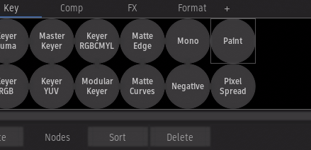

Custom Bins
Create custom bins and populate them with your most commonly used nodes to have them accessible all in one place. As well, change the order of the bins and rename them to identify their contents.
To create a bin:
Click the plus sign tab.
Name the bin in the keyboard that appears.
Note: You can create a maximum of 6 new bins.

To copy a node to another bin:
Drag the node on top of the destination bin.
Release the cursor.
Click the destination bin.
The copied node appears in the bin. Nodes are added to the end of a bin in the order they were copied.
Note: Nodes cannot be duplicated within the same bin.
To reorder a custom bin:
- Click and hold a tab, then drag it to the left or right.
- As the tab follows the cursor, a blue line will indicate where the bin will be inserted when you release it.
If you dragged the bin on top of an existing bin, the existing bin shifts to the right and the moved bin is inserted in its place.
To delete a bin:
Use one of the following methods to delete a bin:
Click and hold a tab, then drag it to the bottom of the screen.
Select the bin and click the Delete button in the Bin section located below the bin.
Warning: There is no undo capability when deleting a bin.The entire contents of the bin, including the bin, are deleted.

To reorder a node:
Click and hold a node, drag it down to detach it from the bin and then drag it to the left or right.
As the node follows the cursor, a blue line will indicate where the node will be inserted when you release it.
Tip: Don't move the node to the viewport or won't be able to drop it back into a bin.
To sort nodes in alphabetical order:
- Select the tab in which the nodes must be sorted.
- Click the Sort button in the Nodes section located below the bin.
