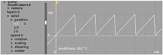

mod
Returns the integer remainder from dividing one number by another. This function is useful for repeating an animation every given number of frames.
| Syntax: | mod(Number, Divisor) |
| Arguments: | - Number is the number to divide.
- Divisor is the number by which you want to divide Number.
| Examples: | - mod(8, 3) returns 2 because 8 divided by 3 is 2 with 2 as the remainder.
- mod(-8, 3) returns -2.
- mod(8, -3) returns 2.
- mod(-8, -3) returns -2.
- mod(7.5, 2.25) returns 0.75.
- mod(frame, 20) * 5 yields the following curve:
