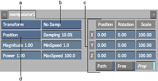

You use the Particle Manipulator menu to select the type of manipulator, its speed and position, and the power of its falloff. To access the Particle Manipulator menu, double-click the particle animator node in the schematic, or follow the tab population rules for the Object menu (see Populating Menu Tabs of Selected Objects).
(a) Manipulator Type box  (b) Damping box  (c) Axis controls  (d) Influence box  
Select the type of manipulator.
Select: To:

Influence box
Select whether the manipulator influences each particle's position or speed.

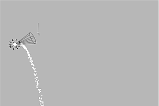

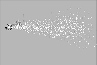

When you influence by position, the position is applied only once. For example, the following figure uses a gravity manipulator to illustrate the difference between position and speed. The gravity manipulator on the left uses the default gravity manipulator with a magnitude of 4 and with position as the influence. The gravity manipulator on the right uses exactly the same settings except the influence is set to speed.
Magnitude field
Displays the unit of measurement specific to each manipulator. Editable.
Magnitude is used by each manipulator for everything from extra scale when using Transform, to a pixel per frame acceleration factor when using AccPoint, AccLine, or AccPlane.
Power field
Displays the amount of falloff from the centre of a manipulator. Editable.
If you specify 0 as the power, there is no falloff; the manipulator's influence is universal. This means that a particle is affected no matter where it is located in the scene. A negative value makes particles that are farther away affected by the manipulator.
Damping box
Select the type of friction to apply (damping affects the speed of particles by applying friction based on each particle's mass, size, or both).

Axis controls
Use these controls to animate the position, rotation, and scale of the manipulator.
ControlDescription
PositionUse the Position X, Y, and Z fields to displace each particle along the X, Y, and Z axes.
RotationUse the Rotation X, Y, and Z fields to rotate each particle. Each particle is not the centre of its rotation. Particles rotate around the manipulator's axis.
ScaleUse the Scale X, Y, and Z fields to increase or decrease the speed or position of each particle along the X, Y, and Z axes. For example, if speed is the selected influence, a Scale X of 100% has no effect while a Scale X of 105% increases the speed along the X axis by 5% with each pass. Enable Prop to proportionally scale the axes.
Enable the Path button to animates the position of the axis using a spline drawn in the scene. Disable Path to animate the position of the axis using explicit animation.
