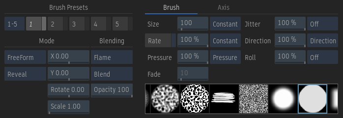

  5. Select a brush.
  6. Select an option from the Paint On box to apply the stroke to the current frame (Cur Frame), all frames in the sequence (Sequence), or on a range of frames (Range, To Frame, or From Frame).
    The range you are painting on appears in the timebar.
  7. Select the Result (F4) or Output Matte (F4 F4) to set the view where you are painting.
    To paint on the result and output matte simultaneously, enable Paint Both.
  8. Set brush attributes.
