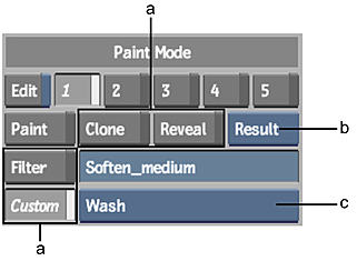

Use the media buttons to enable some Special Effects media, for example, the Clone and Reveal media. Other media types, such as Drag and Smear, are enabled using the Custom Media box.
(a) Special Effects Media buttons (b) Reference box (c) Custom Media box
