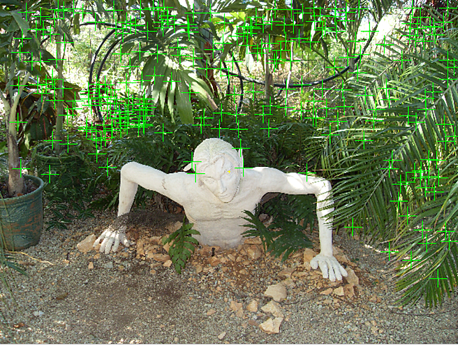

Auto Stabilize
Use the Auto Stabilize to analyse the movement in a clip and remove camera instability. For example, you can remove camera jitter or lock an object's position over a sequence of frames to make it appear motionless.
