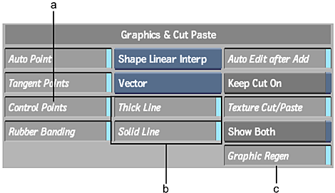

Wireframe Display Options
The Thick Line and Solid Line buttons in the Setup menu determine the thickness and continuity of the wireframe.
(a) Control Points button  (b) Thick Line and Solid Line buttons  (c) Graphic Regen button  
Enabling and disabling the Thick Line and Solid Line buttons affects the wireframe as follows:
  • When Thick Line is enabled, the wireframe has a thickness of 2 pixels.
  • When Thick Line is disabled, the wireframe has a thickness of 1 pixel.
  • When Solid Line is enabled, the wireframe is unbroken.
  • When Solid Line is disabled, the wireframe is dashed.
