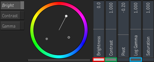

The colour wheel:
- Switch to the various controls using the tabs on the left.
- Display a line from the center to a dot, showing the current setting.
- Displays ghosts dots to show where the other controls are set. The coloured rectangle under the Master sliders define the colour for each control. The dots in the Colour Wheel match the corresponding Master control.
- Works similarly to the Look tool.
- Click & drag in the wheel to move the adjustment in the drag direction.
- Click and drag the dot of a previous adjustment to modify the strength of the adjustment without modifying the relative RGB ratios.
- Control+click in the colour wheel to reset the control.
- Can increase even after the dot has reached the edge of the wheel. In this case, the dot turns into an arrow to indicate that the adjustment lies outside the diameter of the wheel.
The gearing of both the colour wheel and the sliders is set to allow very precise adjustments. However, Alt+Space+click speeds up the slider's response.

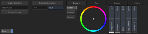

Log Primaries
Brightness slider
The Master component of the Brightness tool. Brightness shifts the entire tonal range lighter or darker. Two units of Brightness adjustment are equivalent to one photographic printer point when working in Academy ADX10 colour space (and a similar amount for many other log spaces).
Contrast slider
The Master component of the Contrast tool. The effect of the Contrast tool is modified by the adjacent Pivot control. A Pivot near grey will preserve midtones while adjusting Contrast. With a Pivot near white, Contrast will behave similarly to Video Gamma.
Pivot slider
Adjusts the Pivot for the Contrast tool. The Pivot sets the point where Contrast adjustments have no effect. A Pivot of -1 corresponds to the minimum value of the logarithmic colour space and a Pivot of +1 corresponds to the maximum value.
Log Gamma slider
The Master component of the Log Gamma tool. Log Gamma applies a power-law adjustment to the logarithmic colour values. (This gives a different effect than traditional Gamma in video colour spaces.) The black and white pivots for Log Gamma may be adjusted in the Controls tab.
Saturation slider
Controls the colour saturation.

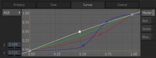

Curves
The Curves are applied after the Primary and Tone controls of a MasterGrade.
Every mode has four curves available: Red, Green, Blue, and Master. The Master curve is applied to R, G, and B equally and after the channel-wise red, green, and blue individual curves.
The curves possess a number of properties peculiar to meet the requirements of a solid grading tool:
- The curves are constrained to be non-decreasing. This prevents solarization/reversal-type artifacts in the image and ensures that the curves are invertible.
- The curves are always continuous in value and first derivative which helps avoid banding artifacts in the image.
- Points may be placed close together to obtain very rapid changes in the curve, however there is a lower limit of 0.02 imposed on how closely the points may be spaced.
- The slope of the curve at the control points is determined by Flame—there are no Bezier-type handles.
- The curves are floating-point and extrapolate linearly beyond the outermost control points.
To display a pixel's colour values in the curves display:
Open the Colour Sampler (Alt+Space+C). The RGB values of the sampled pixel are now shown as matching red, green, and blue vertical lines on the graph.
Drag the colour sampler in the image over the tones that you want to adjust: see where those tones fall on the graph.
If you see a tone you want to adjust and are wondering where on the graph to add points, but you already have some amount of Primary or Tone adjustments in place, set the viewport to the F1 (Front) view.
You want to be in F1 view because the curves happen before the Primary and Tone, and you are trying to locate the incoming values on the graph.
If you are trying to move control points to hit a certain target (for example to neutralize the RGBs) then you want to be in F4 (Result) view.
In this case, you're interested in the cumulative effect of the grade visible from the F4 view.
To add a control point to a curve:
Click the curve selector to select a curve (Master, Red, Green, Blue).
Holding A, click the curve to add a control point.
Release A.
Note: There is a limit of 30 control points in total.
To delete a control point from a curve:
Holding D, click the control point to remove.
Release D.
Note: You cannot delete the last two control points of a curve.
To precisely move control points:
- Dragging in the X and Y fields provides an easy way to precisely adjust only the horizontal or vertical position of a control point or group of points.
- Holding Shift+Meta while pressing an arrow key allows you to make precise, repeatable movements of control points or groups of control points. The increment is set to 0.01 in Video and Log modes, and 0.05 (1/20th of a stop) in Scene-linear mode.
- Right-click the graph and select Translate X or Translate Y. In the calculator that appears, enter an offset.
To constrain movement to one axis:
- Pressing Shift, drag a control point.
To zoom in an out of the graph:
- Ctrl+Space and drag the cursor in the graph.
To pan the graph:
- Space and drag the cursor in the graph.
To reset the view:
- Right-click the graph and select Home.
To reset the graph:
- Right-click the graph and select Reset All.
