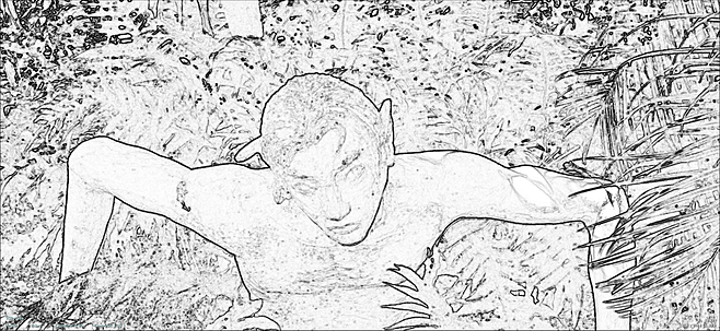

Use Stylize on an image sequence to create a wide range of visual styles, including painting, printing and sketching. Stylize allows you to build your look by stacking layers with different effects.
Stylize includes a collection of 10 core effects that are stacked and blended together as layers. The core effects fall into four major categories: canvas texture, patterns, colour fillings, and outlines. Each of the core effects has its own settings, which display when an effect is selected:
