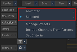

To select a filter preset:
  1. Click Filter Channels drop-down menu.
  2. Select a filter preset. It filters the channels to only display channels that match its filters.
    Note: By default, only Animated and Selected are available. You can create more presets.

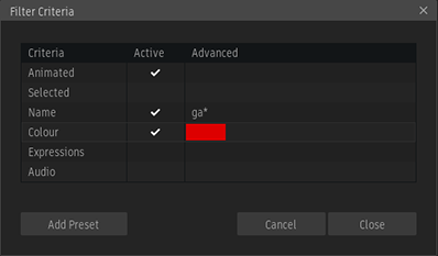

To create a filter preset:
    ![](../images/animChannels-filter menu button.png)
  2. Click Set Criteria.
  3. In the Filter Criteria window, click in the Active column to activate a filter.
  4. Click the Advanced column to set a condition. In this example, the preset displays only channels matching all conditions:
    • Is animated.
    • Has a name that begins with ga, like gain and gamma.
    • Is coloured red.
  5. Click Add Preset to save this filter configuration.
  6. Name the preset, and click Enter to save it.
    The preset is immediately applied and is now available in the Filter Channels drop-down menu.
Note: If the preset you create is identical to an existing preset, clicking Add Preset does nothing.
