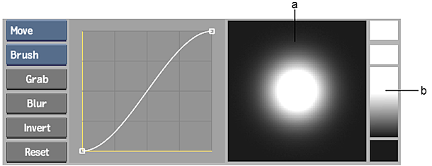

You can draw a new brush shape or update the current brush shape in the editing panel. The new shape is drawn using the brush that you selected to open the Custom Brush menu.
(a) Editing panel (b) Gradient bar

To draw a brush shape:
- To create a new shape, erase the existing brush shape by painting over the editing panel.
- Draw the new shape.
- To invert the brush shape, click Invert.
- To blur the brush shape, click Blur. Each time you click Blur, a 3 x 3 filter is applied to the brush image.
