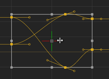

To move the selected points:
  • Click and drag inside the Edit Box to move the points freely.
  • Click and drag one of branches of the pivot to constraint the movement the X or Y axis.

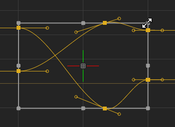

To scale the selected points:
  • Click and drag one of the Edit Box handles.
    Note: In the Dope Sheet, you can only scale the keyframes on the X (time) axis.
To scale proportionally around the Edit Box pivot point.
  • Shift+Alt+Click-drag an Edit Box handle.
To scale symmetrically around the Edit Box pivot point.
  • If the Pivot is at the center of the Edit Box, Alt+Click-drag an Edit Box handle.
  • If the Pivot is off-center, Click-drag an Edit Box handle.
To scale freely and ignore the Edit Box pivot.
  • If the Pivot is at the center of the Edit Box, Click-drag an Edit Box handle.
  • If the Pivot is off-center, Alt+Click-drag an Edit Box handle.
The Scale Edit Box Proportional keyboard shortcut can be used to apply a proportional scaling around the pivot. The keyboard shortcut is assigned to Shift+Alt in all keyboard shortcuts profiles.

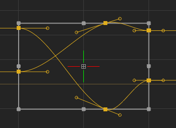

Moving the Edit Box Pivot gives you the flexibility to scale the keyframes around a different center.
To move th Edit Box Pivot, do one of the following:
  • Click-drag the Pivot in the canvas.
  • Right-click a keyframe and select Pivot and select Move Edit Box Pivot.
  • Use one of these keyboard shortcuts:
    • Flame and Lustre profiles: Shift+Command+Click the canvas.
    • **Smoke Classic profile:**Ctrl+Alt+Click the canvas.
    • **Smoke (FCP 7) profile:**Alt+Command+Click the canvas.
When you move the Pivot, its appearance changes to indicate it is no longer centered in the Edit Box.
Centered PivotOff-center Pivot

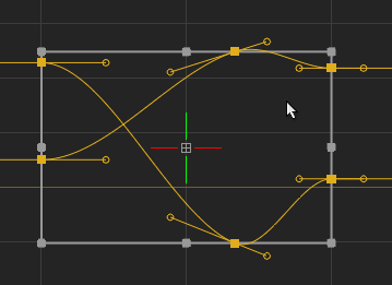

To move Pivot back to the center of the Edit Box:
  1. Right-click the Pivot and select Reset Edit Box Pivot.
  2. Alt+click the Pivot.
