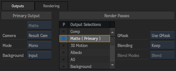

Rendering Outputs from the GMask Tracer
Use the multi-pass rendering capabilities of the GMask Tracer's Output menu to manage your outputs. You are limited to Matte primary outputs, but you can have multiple render passes. The overall functionality of the Output menu is otherwise similar to the Action Output menu.
The Comp output of a GMask Tracer outputs the input, so it can be used as a pass-through, or can be used in the Camera FX pipeline.
One difference from Action, is that you have an extra option in the Matte Background box for GMask Tracer outputs. The Input option allows you to set the incoming Media Front and Matte as the Background for both the Comp and Matte outputs respectively.
Note: If you accessed the GMask Tracer as a Timeline FX, you are limited one Matte output.
