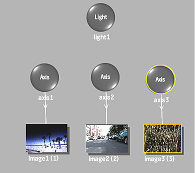

Add multiple surfaces to the scene.
Add a light to the scene.
All surfaces are illuminated.

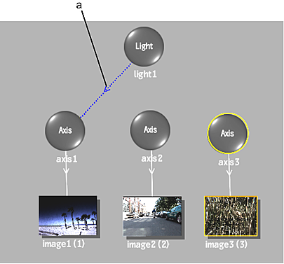

Select Light Link from the Tools box.
To illuminate only a selected surface, click the light node, and drag it to an axis or image you want illuminated.
The selected object is connected to the light source by a blue dotted line with an arrow, and only the selected surfaces are illuminated.
(a) Light inclusion link

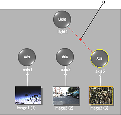

To exclude a surface, hold the Alt key while clicking and dragging from the light source to the surface you do not want illuminated.
Excluded surfaces are connected to the light source by a red dotted line with an “X”, and they are not illuminated. In the following example, all surfaces are illuminated, except for image3, which is excluded.
(a) Light exclusion link
