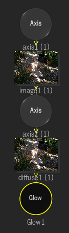

Matchbox Shaders Connected to Texture Nodes
To add a Matchbox node in Action connected to a Texture node:
Do one of the following:
With a supported texture node selected in the schematic (Diffuse, Normal, UV, Displacement (HW Only), Parallax, IBL, Specular, Emissive, Lens Flare texture, or Substance texture), double-click the Matchbox node in the All Nodes bin.
The file browser opens to allow you to select a Matchbox effect.
With an Action surface or 3D Geometry node selected in the schematic, double-click a Matchbox preset node from the dynamic Matchbox node bin.
The Matchbox node with a parented Diffuse node (with its own parent axis) are added to the scene as children of the selected surface or geometry.
Tip: If you add a Matchbox node to the schematic without a supported texture node present, you can parent the Matchbox to an image, and a Diffuse Map node (with accompanying Axis) is automatically added to create a proper Matchbox connection. Matchbox nodes are not supported on Stereo objects.Matchbox nodes and their links are displayed as black in the schematic to help you identify them. If you added the Matchbox from the dynamic node bin, the name of the effect also appears on the node in the schematic.
