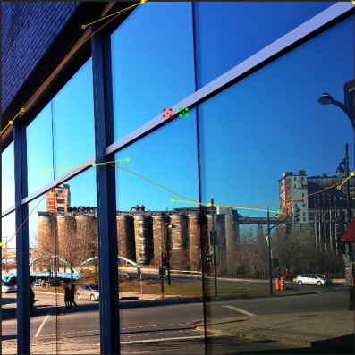

  1. Add a GMask to your scene.
    Tip: You can also use a 3D Shape node, since a GMask node is automatically added to its branch.
  2. Switch to F8 Object view and draw your GMask.
  3. From the Use Media field in the GMask menu's Tracer tab, select the media to use with the tracer (to use the Back media, select 0).
  4. Identify which frame you would like to create your first key shape on and click Add.

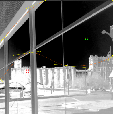

    Doing so creates two colour picker boxes in the centre of the GMask shape; one to identify the Background colour (green box) that you would like to key out, and the other the Foreground colour that you would like to preserve (red box).
  5. Resize and position the colour picker boxes, as needed.
    Tip: If colour picker boxes are overlapping, press Q to toggle between selections.
  6. If needed, use the Add Background and Add Foreground buttons to add and position more colour pickers at the same frame.
  7. Use other settings in the Tracer menu, such as to add softness, invert the colour pickers, apply to the GMask gradient only, or add post-processing refinements.
    Tip: Click F8 again to see the result of the keying operation in context.
