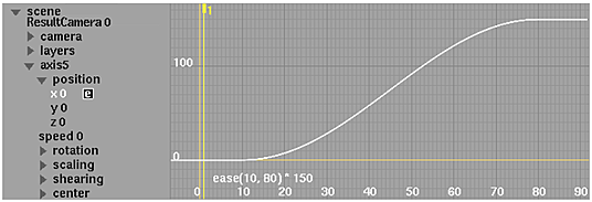

- ease(10, 80) * 150 yields the following curve:

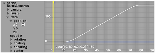

- ease(10, 80, 0.2, 0.2) * 150 yields the following curve:

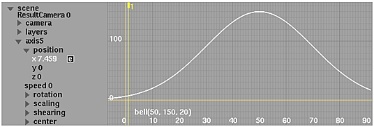

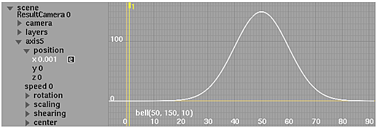

- bell(50, 150, 10) yields the following curve:
- bell(50, 150, 20) yields the following curve:
