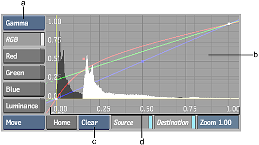

(a) Trackball option box  (b) Gamma curves  (c) Reset box  (d) Luma range  

  3. Display the gamma curve(s) you want to adjust.
    Enable:To display:
    RGBThe R, G, and B gamma curves at the same time.
    Red, Green, or BlueThe R, G, or B gamma curve individually.
    LuminanceThe Luminance curve. Use this curve to modify luminance levels locally without affecting the overall luminance.

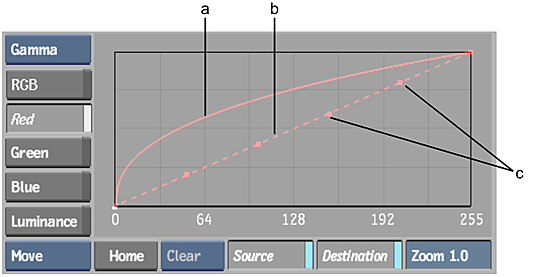

    Two curves are displayed for each channel, the original gamma curve, and an adjustment curve with control points for regional control. Initially these curves overlap.
    (a) Red channel's gamma curve  (b) Red channel's adjustment curve  (c) Added control points on adjustment curve  

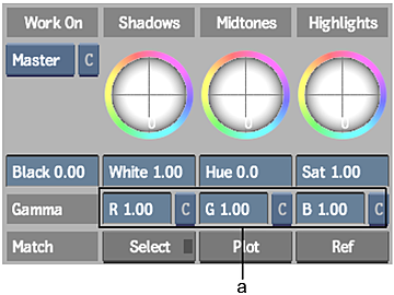

    • To modify R, G, and B gamma values individually across the entire luma range (from black to white), click and drag in the Gamma R, G, and B fields. Drag left to increase contrast or right to decrease contrast. You can also enter a value directly in these fields. Enter a low value to increase contrast or a high value to decrease contrast.
    Only the field you modified is updated. The gamma curves are also updated to reflect your changes. The gamma curve is offset from its dotted adjustment curve. Use the adjustment curve to make regional adjustments to the channel.
    (a) RGB Gamma Fields
    • To modify R, G, and B gamma values proportionally across the entire luma range (from black to white), Alt-drag the Gamma R, G, or B field. Drag left to increase contrast or right to decrease contrast.
    All three fields are updated. The gamma curves are also updated to reflect your changes. The gamma curves are offset from their dotted adjustment curves. Use the adjustment curve to make regional adjustments to the channel.
