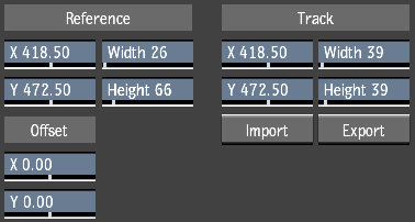

    • To resize the reference box and tracker box interactively on the frame, press a resize handle on the box and drag.
    • To use the menu to move or resize the reference or tracker box for the current tracker, enter values in the Reference or Track fields.
      You can also set the position of the offset the position of the reference, via the Offset X and Y fields. See Offsetting the Tracking Motion of the Reference.
    Tip: Use the image window Zoom command to get a closer view of the tracker and reference boxes.
    Note: To reset the reference or tracker box to its default position and size, select either Reset Ref, Reset Track or Reset Shift from the Reset box.
