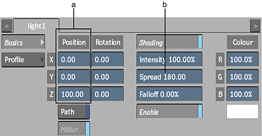

  3. Adjust the spread and position of the light source in the Light menu. Use the Spread field to set the spread of the particle stream. The Intensity, Falloff, and Colour fields are not used by the particle generator.
    (a) Position fields  (b) Spread field  

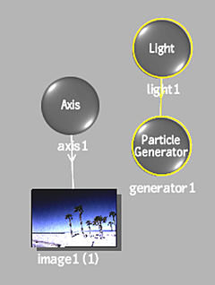

  4. With the light node selected in the schematic, do one of the following:
    • Drag the particle generator node from the node bin and place it in the schematic.
    • Double-click the particle generator node. You do not need to be in Schematic view to add a node in this manner.
    A particle generator object is added and automatically connected to the selected light source.
