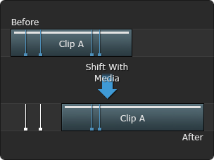

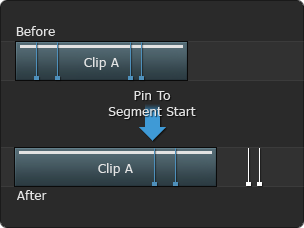

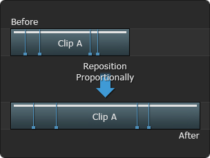

  3. Select how the animation channel is affected when you slide the animated effects by choosing an option from the Keyframe Move Modes box.
    Select:To:Example
    Reposition ProportionallyResize the channel as you trim. The animation channel is scaled to fit into the timeline element. This option has no effect when you slip or slide.
    Shift With MediaLink the keyframes to their original frame numbers. The animation channel moves to follow the original frames as you trim.
    Pin To Segment StartUnlink the keyframes from their original frame number. The animation channel remains with the timeline element as you trim.
