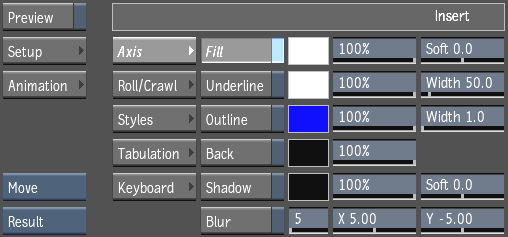

(a) Setup button  (b) Animation button  (c) Attribute controls  (d) Text Mode box  

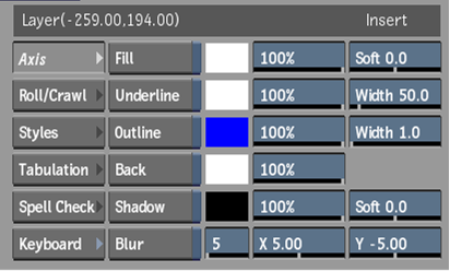

Insert Settings
Axis button
Opens the Axis menu to set properties for layers and characters.
Roll/Crawl button
Open the Roll/Crawl menu to set text motion properties for vertical or horizontal text scrolling.
See Creating Text Rolls and Text Crawls.

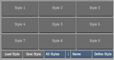

Styles button
Opens the Styles menu to create preset text style formats.
See Defining Styles
Tabulation button
Open the Tabulation menu to set text tabs.
See Tabulating Text
Keyboard button
Opens the on-screen keyboard to enter text.
See Entering Text
Fill button
Enable to use fill on the text selection.
Sets fill colour, transparency, and softness. Set fill softness using the Soft field. To increase the softness, enter a value close to the maximum of 100. To decrease the softness, enter a value close to the minimum of -100. Enter 0 for no softness.
Fill colour pot
Displays the colour of the fill. Editable.
Fill Transparency field
Displays the transparency level of the fill. Editable.
Fill Softness field
Displays the softness level of the fill. Editable.
Underline button
Enable to underline the text selection.
Underlines the characters using the associated colour, transparency, and width. Click the colour pot to choose a colour from the colour picker. To set underline transparency, enter a percentage in the Transparency field. To make the underline more opaque, enter a value close to the maximum of 100. To make the underline more transparent, enter a value close to the minimum of 0. To set the outline width, enter a value in the Width field.
Underline colour pot
Displays the colour of the underline. Editable.
Underline Transparency field
Displays the transparency level of the underline. Editable.
Underline Width field
Displays the width of the underline. Editable.
Outline button
Enable to outline the text selection.
Outlines the characters with a solid colour using the associated colour, transparency, and width. Click the colour pot to choose a colour from the colour picker. To set outline transparency, enter a percentage in the Transparency field. To make the outline more opaque, enter a value close to the maximum of 100. To make the outline more transparent, enter a value close to the minimum of 0.
To set the outline width, enter a value in the Width field. Use anti-aliasing rendering options with outlined text. These options are found in the Text Setup menu. See Setup and Rendering Options.
Outline colour pot
Displays the colour of the outline. Editable.
Outline Transparency field
Displays the transparency level of the outline. Editable.
Outline Width field
Displays the width of the outline. Editable.
Back button
Enable to apply a solid colour background using the associated text layer colour and transparency to the text selection.
Click the colour pot to choose a colour from the colour picker. To set back transparency, enter a percentage in the Transparency field. To make the back more opaque, enter a value close to the maximum of 100. To make the back more transparent, enter a value close to the minimum of 0.
Back colour pot
Displays the colour of the background. Editable.
Back Transparency field
Displays the transparency level of the background. Editable.
Shadow button
Enable to apply a drop shadow to the text selection.
Applies a shadow to text characters using the associated colour, softness, transparency, and Pos X and Pos Y fields. Click the colour pot to choose a colour from the colour picker. To set shadow transparency, enter a percentage in the Transparency field. To make the shadow more opaque, enter a value close to the maximum of 100. To make the shadow more transparent, enter a value close to the minimum of 0. To set shadow softness, use the Soft field. To increase the softness, enter a value close to the maximum of 100. Enter 0 for no softness.
To set the shadow position on the X-axis, enter a value in the X field. A positive value places the shadow to the right and behind the text characters. A negative value places the shadow to the left and in front of the text characters. To set the shadow position on the Y-axis, enter a value in the Y field. A positive value moves the shadow up. A negative value moves the shadow down.
Shadow colour pot
Displays the colour of the shadow. Editable.
Shadow Transparency field
Displays the transparency level of the shadow. Editable.
Shadow Softness field
Displays the softness level of the shadow. Editable.
Shadow X field
Displays the shadow position along the X-axis.
Shadow Y field
Displays the shadow position along the Y-axis.
Blur Shadow button
Enable to apply a blur effect to a drop shadow created with the Shadow button.
The type of blur applied depends on whether Box Blur or Gaussian Blur is selected in the Text Setup menu. Choose a higher value for a greater shadow blur effect. Using Blur Shadow with animated text decreases processing performance.
Blur Shadow field
Displays the level of blur applied to the drop shadow. Editable.

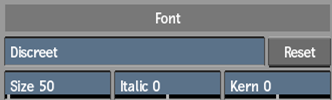

Font Settings
Font field
Displays the current font. Click to open the font browser to select a different font.
Font Reset button
Resets to the default font.
Font Size field
Displays the character size for the selected font. Editable.
Font Italic field
Displays the angle of italicized text. Positive values make the characters slope to the right. Negative values make them slope to the left.
Font Kerning field
Displays the amount of spacing between characters. Positive values increase the spacing. Negative values decrease the spacing.

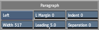

Paragraph Settings
Justification box
Select an alignment option for the paragraph.
Select Left, Right, Centre, or Justified.
Width field
Displays the width at which to crop the text within the text roll or crawl layer. Editable.
Left Margin field
Displays the amount of space in the left margin. Editable.
Leading field
Displays the space between lines in the selected paragraph. Editable.
Indent field
Displays the left indentation value for the first line in the paragraph. Editable.
Separation field
Displays the space between the selected paragraph and the one above it. Editable.

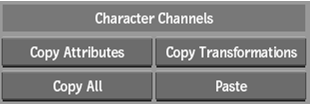

Character Channels
Copy Attributes button
Copies attribute settings from the selected text character.
Copy Transformations button
Copies transformation settings from the selected text character.
Copy All button
Copies both attribute and transformation settings from the selected text character.
Paste button
Pastes any copied text character channel information.

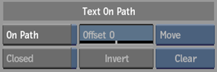

Text on Path
On Path button
Enable to place the selected text on a motion path.
Closed button
Enable to close the path by connecting the first and last vertices. Text continues around the shape.
Offset field
Displays the position of the text on the path. Animate the Offset value to make the text follow the path for the duration of the clip.
Invert button
Reverses the order of the vertices on the path so that the text follows the opposite side of the path.
Text On Path Mode box
Select an option to manipulate the selected path spline.
Clear button
Resets the text path at the current frame. To reset the path for the entire duration of the clip, click Reset Layer.

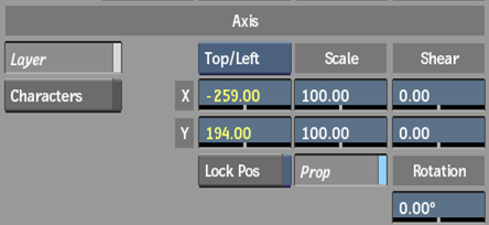

Axis Settings
Note: The Axis settings are available when the Axis button is enabled in the Insert settings.
Axis menu buttons
Select whether to display the Layer Axis menu or the Characters Axis menu.
Show Axis button
Enable to display the axis in the image window.
This button is only available when the Character Axis menu button is selected.
Position X field
Moves the layer or selected characters along the X axis. Editable.
Increase the value to move right and decrease it to move left.
Y Position field
Moves the layer or selected characters along the Y axis. Editable.
Increase the value to move up and decrease it to move down.
Lock Position button
Enable to lock the position of the text layer to either the Top/Left or Centre position.
Centre Axis button
Moves the axis to the center point of the character.
X Position Character Axis field
Sets the X-axis for the selected characters. Set each letter in a word spinning on its own axis in a different way.
Using the Axis Pos X field, you set each letter in a word spinning on its own axis in a different way.
Y Position Character Axis field
Sets the Y-axis for the selected characters. Set each letter in a word spinning on its own axis in a different way.
Using the Axis Pos Y field, you set each letter in a word spinning on its own axis in a different way.
X Scale field
Scales the layer or selected characters along the X-axis. Editable.
This value is a percentage, so entering 50 means 50 percent. Use a larger value to increase the scale along the X axis. Use a negative value to create a mirror image on the X axis. Enter 0 to make a layer or selected characters disappear.
Y Scale field
Scales the layer or selected characters along the Y-axis. Editable.
This value is a percentage, so entering 50 means 50 percent. Use a larger value to increase the scale along the Y axis. Use a negative value to create a mirror image on the Y axis. Enter 0 to make a layer or selected characters disappear.
Proportional Scale button
Proportionally changes the Scale X and Y values.
X Shear field
Shears or slants the layer or selected characters along the X-axis.
Use a positive value to slant right and a negative value to slant left.
Y Shear field
Shears or slants the layer or selected characters along the Y-axis.
Rotation field
Rotates a layer around its axis or selected characters around their axis. Editable.
Use a negative value to rotate clockwise and a positive value to rotate counter-clockwise.

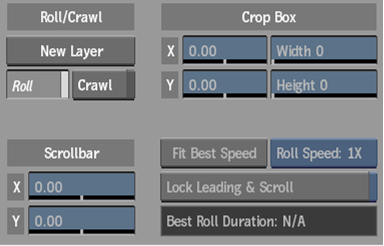

Roll/Crawl Settings
Note: The Roll/Crawl settings are available when the Roll/Crawl button is enabled in the Insert settings.
Roll/Crawl Settings
New Layer button
Creates a layer to contain a text roll or text crawl.
Roll button
Enable to create text that scrolls vertically over an image.
Crawl button
Enable to create text that scrolls horizontally across an image.
Scrollbar
Scrollbar X field
Displays the X position of the roll or crawl layer inside the crop box. The value changes when you move the scrollbar at the right of the text layer for a roll or at the bottom of the layer for a crawl. Editable.
Scrollbar Y field
Displays the Y position of the roll or crawl layer inside the crop box. The value changes when you move the scrollbar at the right of the text layer for a roll or at the bottom of the layer for a crawl. Editable.
Fit Best Speed button
Creates a broadcast quality text roll based on the number of frames in the clip and the lines of text in the text roll. Enable this button to make corrections to a text roll without altering the speed or duration of the clip.

Roll Speed button
Select the speed of the text roll, in pixels per second.
Changes the speed of the text roll. For 1X, the speed rate is 120 p/s (pixels/second) in NTSC, and 100 p/s in PAL. For 2X, it is 240 p/s in NTSC, and 200 p/s in PAL, and so on.
Lock Leading & Scroll button
Enable to lock the leading of the paragraph text so that you can insert another paragraph into the text roll. If the duration of the clip lengthens after you make modifications, click Fit Best Speed to adjust the length.
Best Roll Duration field
Displays the suggested duration for the text roll. The duration is calculated using the start/end position of the roll and the currently selected speed. Non-editable.
Crop Box
Crop Box X field
Displays the X position of the crop box inside the image window. The crop box determines the X coordinates of the text roll or text crawl on the clip. Editable.
Crop Box Y field
Displays the Y position of the crop box inside the image window. The crop box determines the Y coordinates of the text roll or text crawl on the clip. Editable.
Width field
Height field
Displays the height at which to crop the text within the text roll or crawl layer. Editable.
Styles Settings
Note: The Styles settings are available when the Styles button is enabled in the Insert settings.
Apply Style 1 button
Saves or applies Style 1.
Apply Style 2 button
Saves or applies Style 2.
Apply Style 3 button
Saves or applies Style 3.
Apply Style 4 button
Saves or applies Style 4.
Apply Style 5 button
Saves or applies Style 5.
Apply Style 6 button
Saves or applies Style 6.
Apply Style 7 button
Saves or applies Style 7.
Apply Style 8 button
Saves or applies Style 8.
Apply Style 9 button
Saves or applies Style 9.
Load Style button
Opens the file browser where you can select a saved style to load.
Save Style button
Opens the file browser where you can save a style.
Style Mode box
Select whether to work with all styles or one style.
Style Save Number box
Select the number of the style to save. Available when One Style is selected from the Style Mode box.
Style Name button
Sets the name of a defined style.
Style Option box
Select an option for creating styles. AutoStyle assigns styles from an existing layer.

Layer Axis box
Select an alignment option for the selected text layer.
Select:To move the axis:
Top/LeftTo the upper-left corner of the text layer.
CentreTo the centre point of the text layer.
X Scale field
Displays the scale of the text layer along the X axis. Editable.
This value is a percentage, so entering 50 means 50 percent. Use a larger value to increase the scale along the X-axis. Use a negative value to create a mirror image on the X-axis. Enter 0 to make a layer or selected characters disappear.
Y Scale field
Displays the scale of the text layer along the Y axis. Editable.
This value is a percentage, so entering 50 means 50 percent. Use a larger value to increase the scale along the Y-axis. Use a negative value to create a mirror image on the Y-axis. Enter 0 to make the layer or selected characters disappear.
Enable to proportionally change the X Scale and Y Scale values.
X Shear field
Displays the shear or slant value of the text layer along the X axis. Editable.
Y Shear field
Displays the shear or slant value of the text layer along the Y axis. Editable.
Use a positive value to shear up and a negative value to shear down.
Rotation field
Displays a rotation value for a layer rotating around its axis. Editable.
